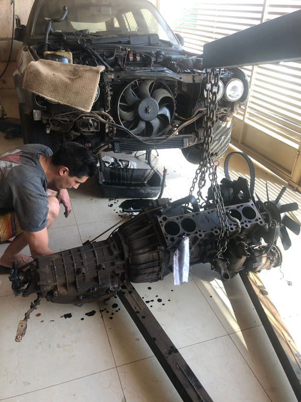

It is a BMW E30 Touring, originally with an M21B24 engine.
I'm from Brazil, and I like the Brazilian way. I decided to make some changes but the project is still in progress.
List of upgrades
Engine
- Pistons 0,50 M51
- Crankshaft s52 89,6mm
- mechanical injector (I already bought the car without the injection pump which was electronic, I bought the electronic one and checked it but it didn't work.)
Gearbox (Before it was automatic)
Gs6-37DZ - 6 gears
Diff
2.93 Torsen
In Brazil there are almost no small cars with diesel engines, the country banned it, but as this car was bought by a Portuguese ambassador, who after the service returned to his country of origin and the car was sold to a private individual
My fear was that I wouldn't be able to get spare parts, so I ended up buying a 524TD that was wasted for running illegally in Brazil.
The engine is already running, the engine has not exploded (yet)
Gearbox and cardan in place, but the car is dismantled for painting and without brakes and clutch pedal

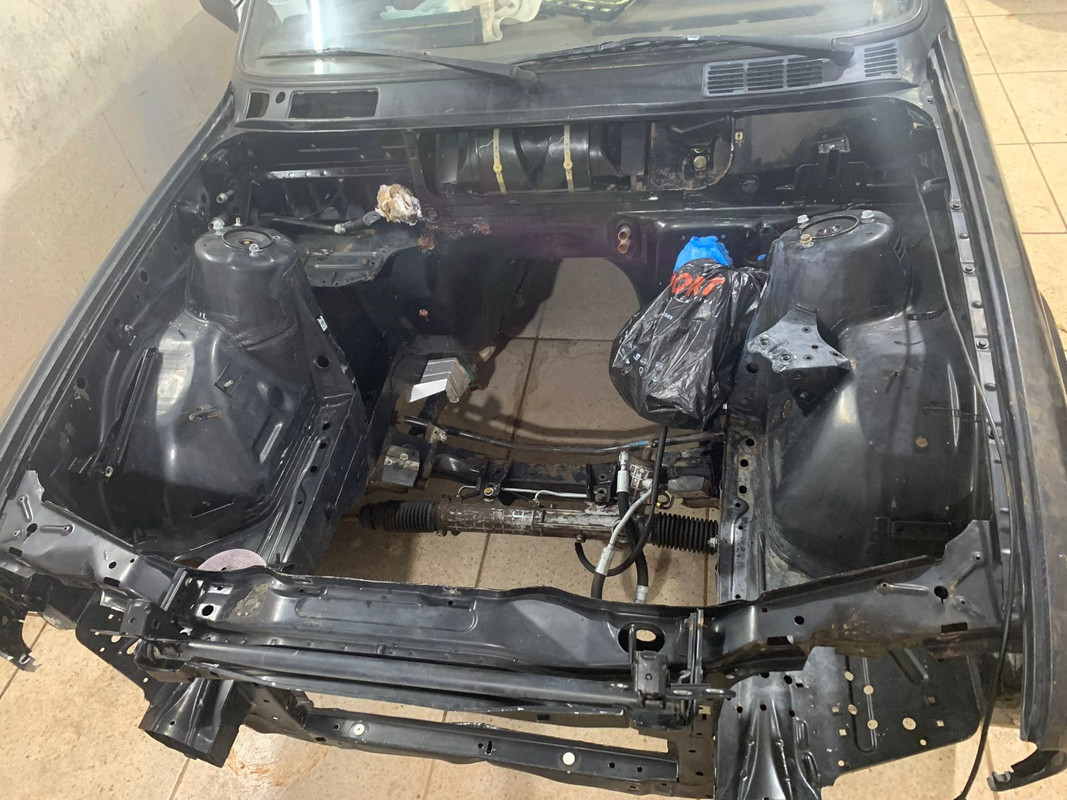

Before paint engine bay

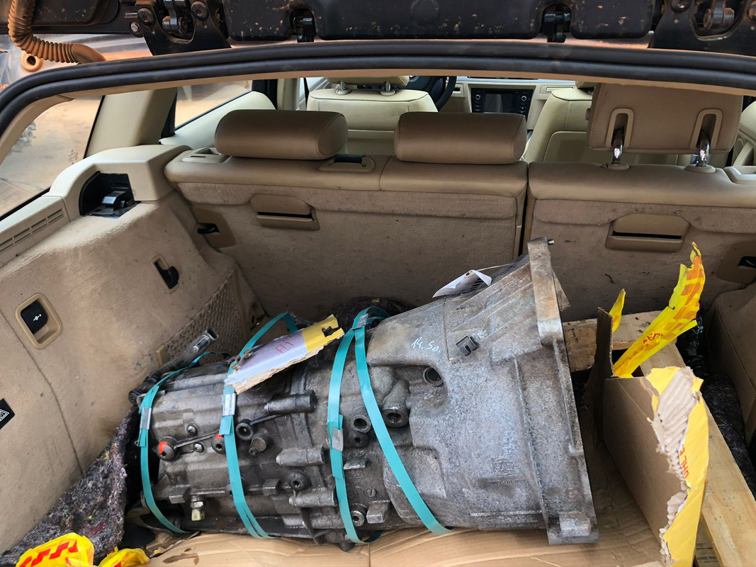

Gearbox ZF GS6-37dz

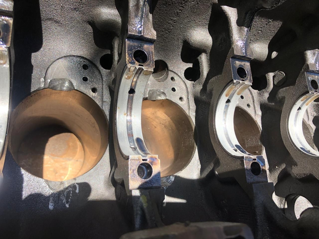

Engine block

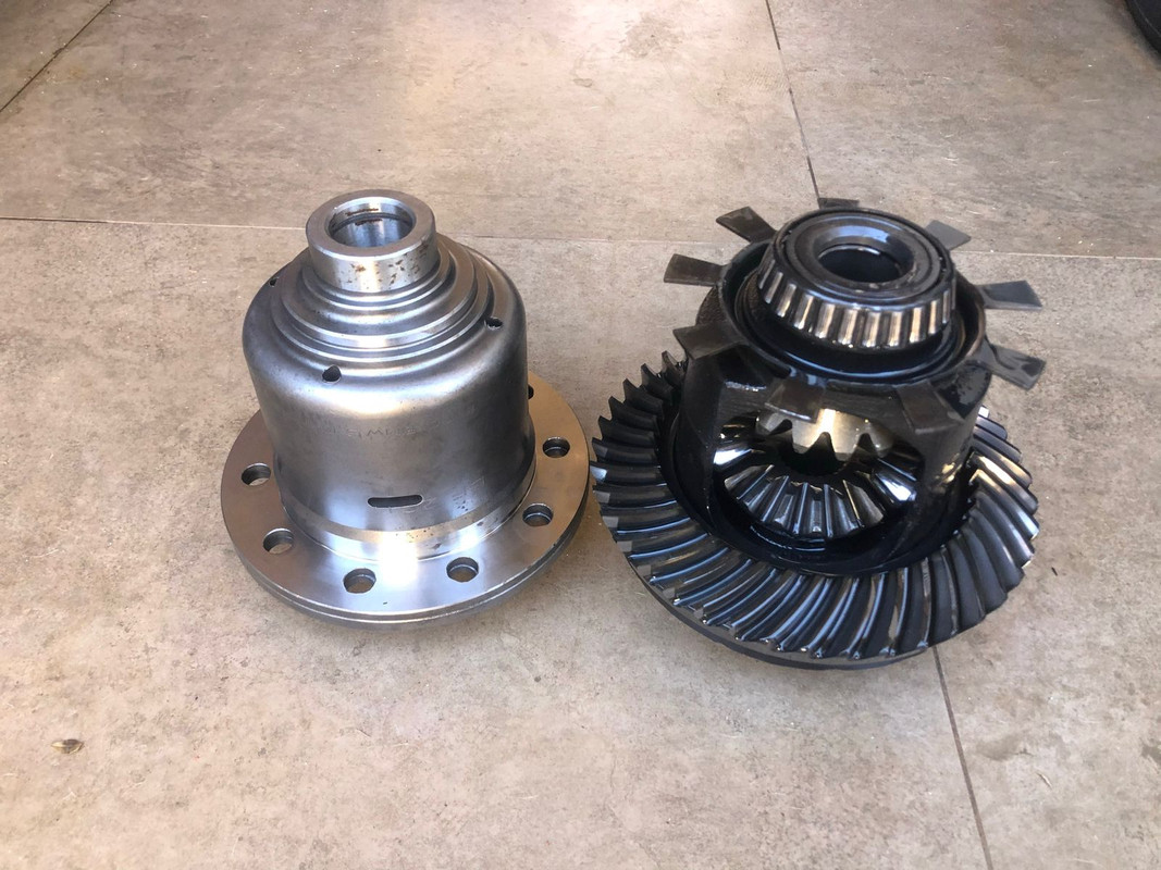

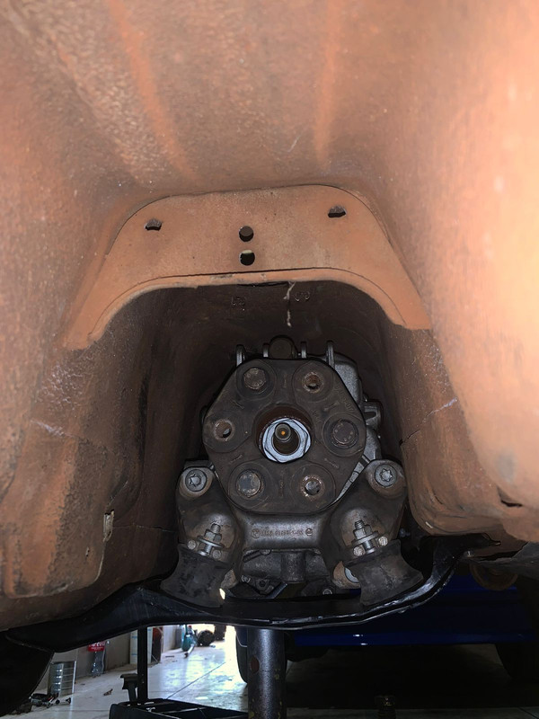

Torsen and 2.93 gear (before 3.25)

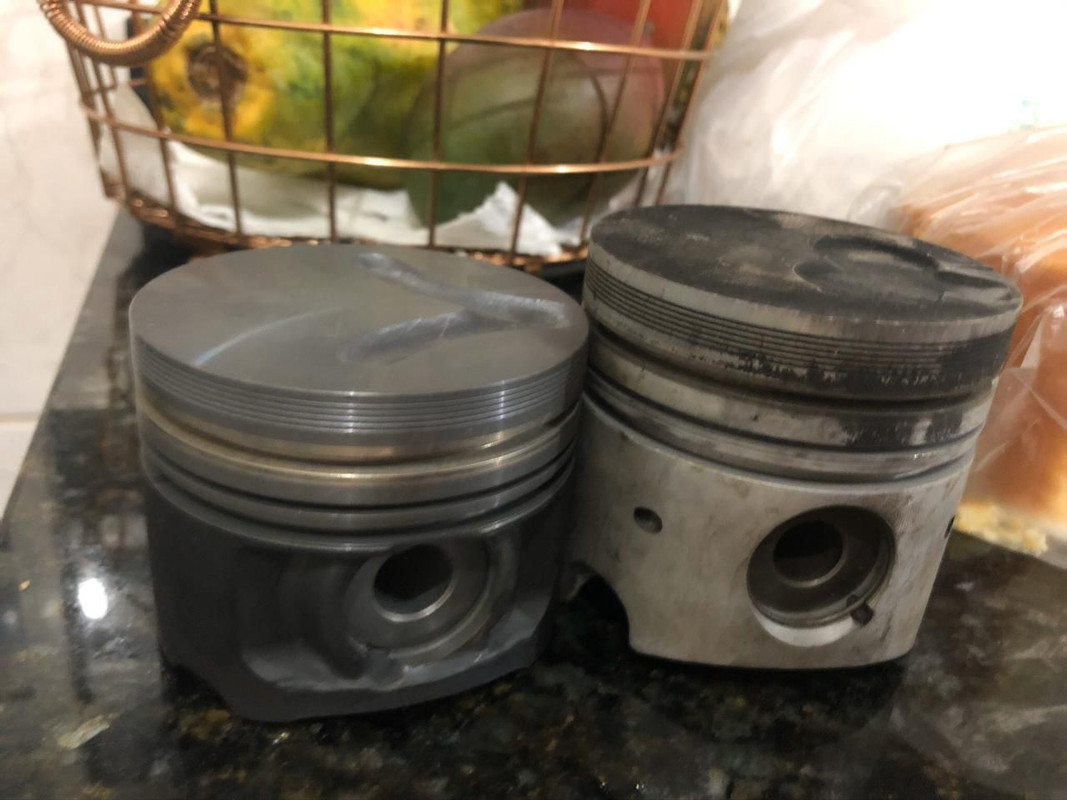

m51 piston x m21 piston ( I used them to compensate for the difference in crankshaft stroke)

Piston m51 and m21
It was necessary to do a little sanding so that the crankshaft could spin freely without the connecting rods touching the block.
The S52 crankshaft was also a problem, as it used short 130mm connecting rods from the m21 engine, it was necessary to machine the crankshaft counterweights, then the assembly was balanced.
