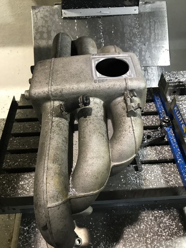

So far, to make the fit clean and sexy, I slapped together a jig to hold the manifold level in the mill, and programed in a flat cut to set the TB on:
Here it is with the flat and the TB air hole (pic taken before mounting bolt holes were drilled):
So far the plan is to machine a spacer plate with thru holes, as the TB doesn't sit nicely in that milled section, as protrusions from the TB interfere with the rest of the casting of the intake manifold. I will see how it works to run bolts through the inside of the intake out thru the spacer and thru the TB and with nuts on the outside. Access to insert and hold the bolts should be easy through the factory TB opening. I plan to use lock nuts or jamb nuts, maybe with thread lock as well to prevent the nuts from backing off the bolts, but I figure the risk of a nut backing all the way off and a bolt falling into the throttle body is very small, especially with the nuts visible from the outside.

another possible route, and I don't know if it would have any advantage, is Fox Mustang stuff. Those also have an idle control motor that bolts to the side of the throttle body but the mounting is just a round hole with 4 bolts around the flange. Could probably plunk one of those in the flattened space from the first pic.
