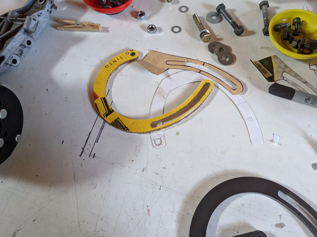

Thus, after several days of tinkering with pencil & CAD (cardboard aided design) I came up with a simplistic solution that might just work.

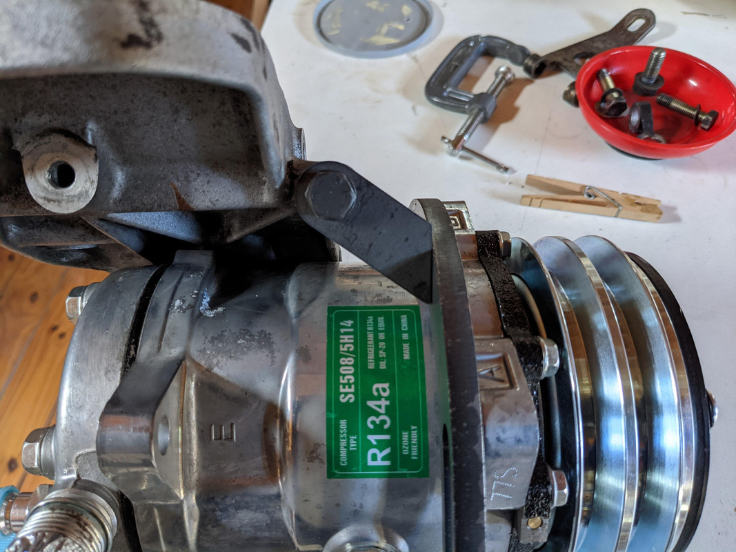

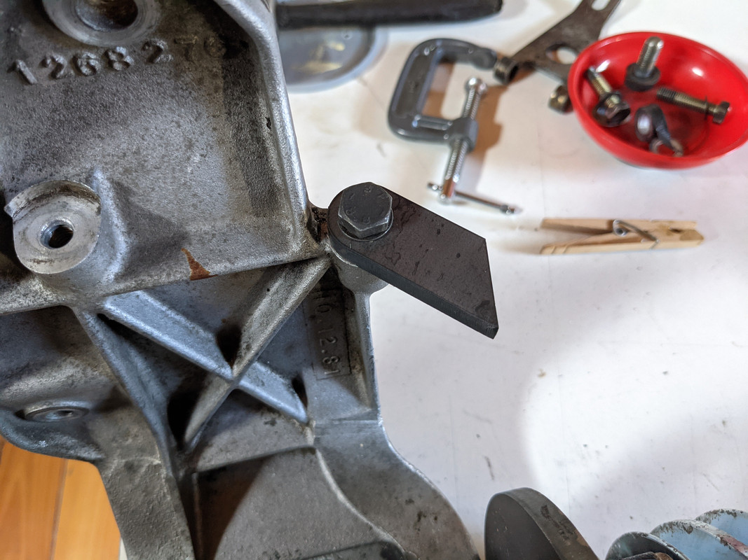

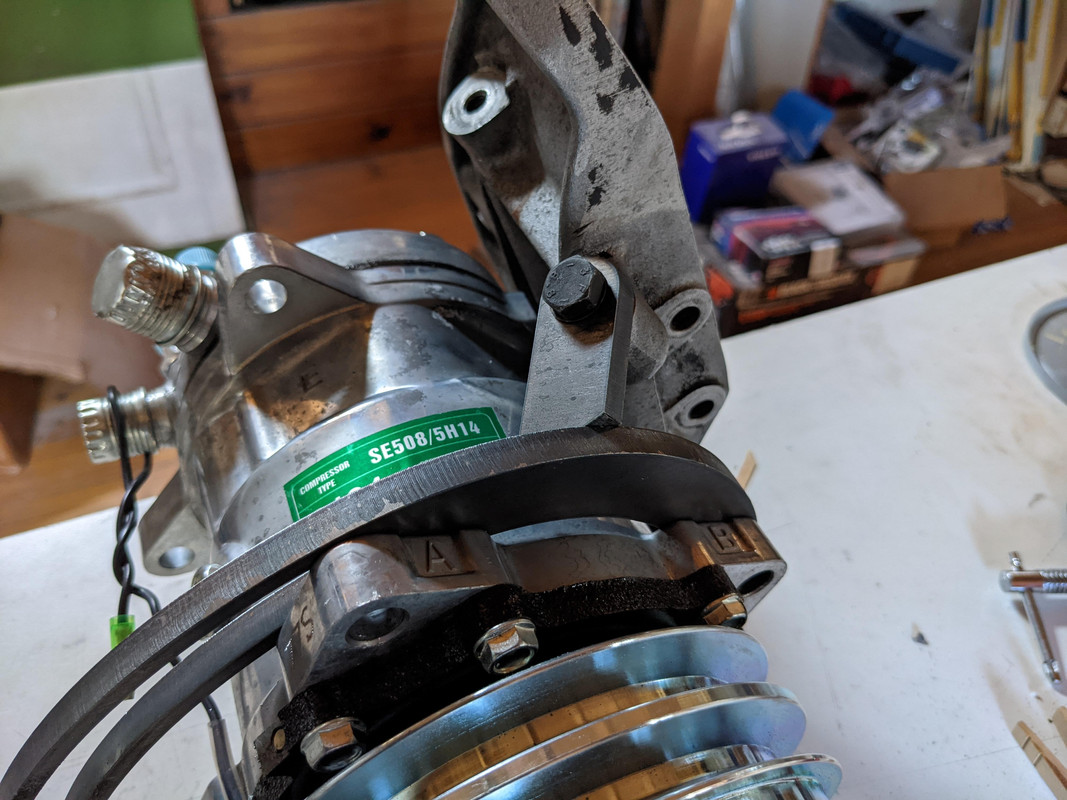

The bottom mounting holes on the factory bracket have the same diameter as the sanden, so I needed to fashion an 8mm or 5/16" spacer to get the pulley aligned.
Anyway, I decided to combine the spacer and adjuster into 1 piece of the appropiate thickness, as per the photos:
OG bracketry:

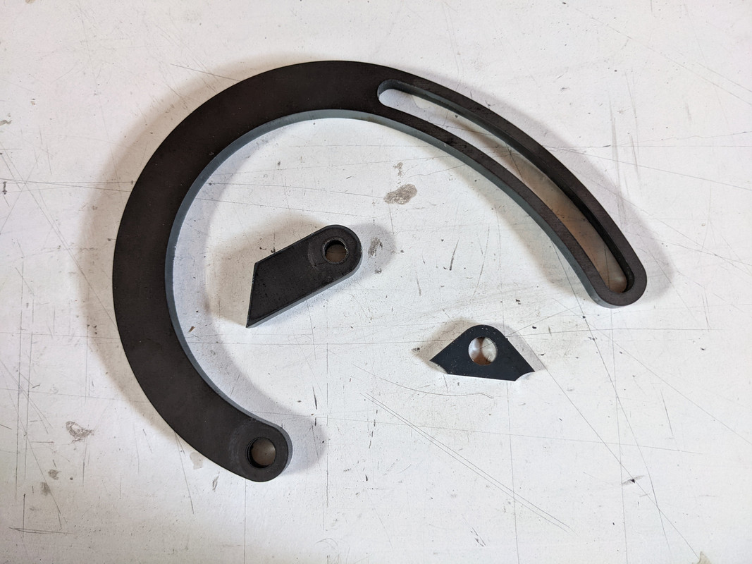

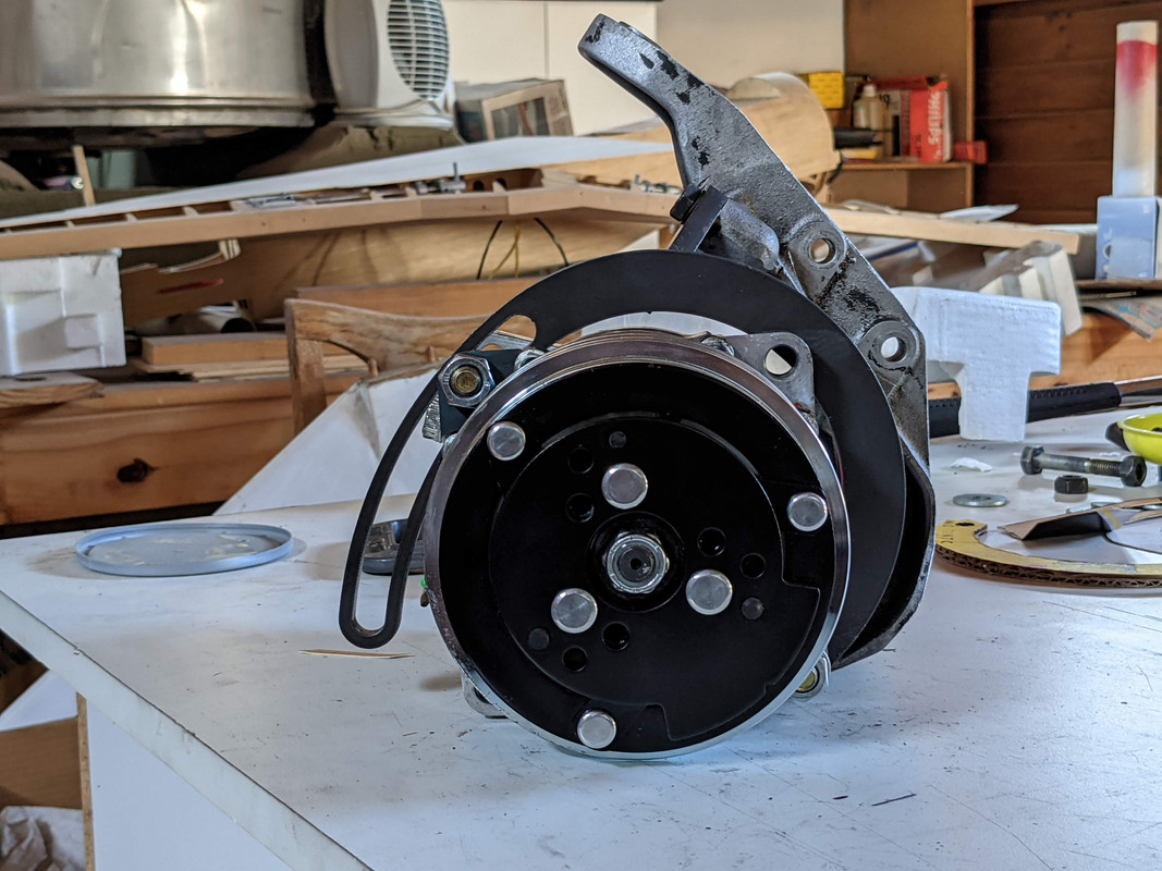

I ended up with these designs in Autocad, and had them laser cut

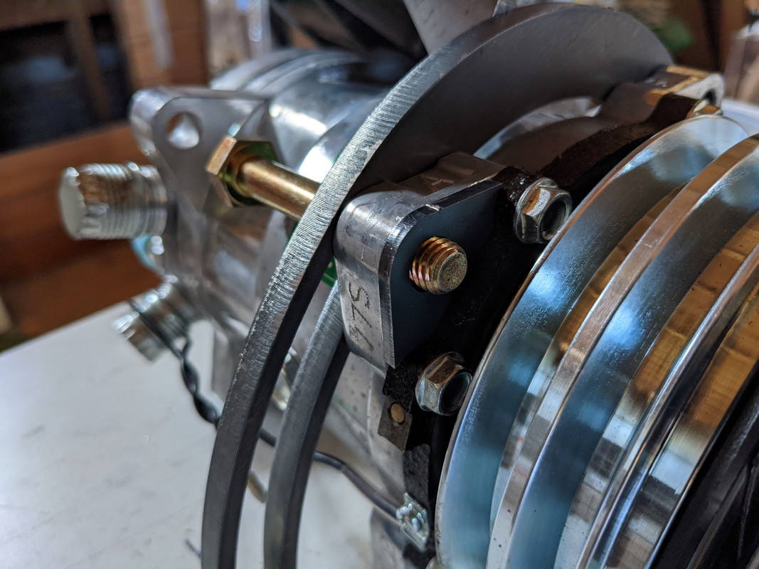

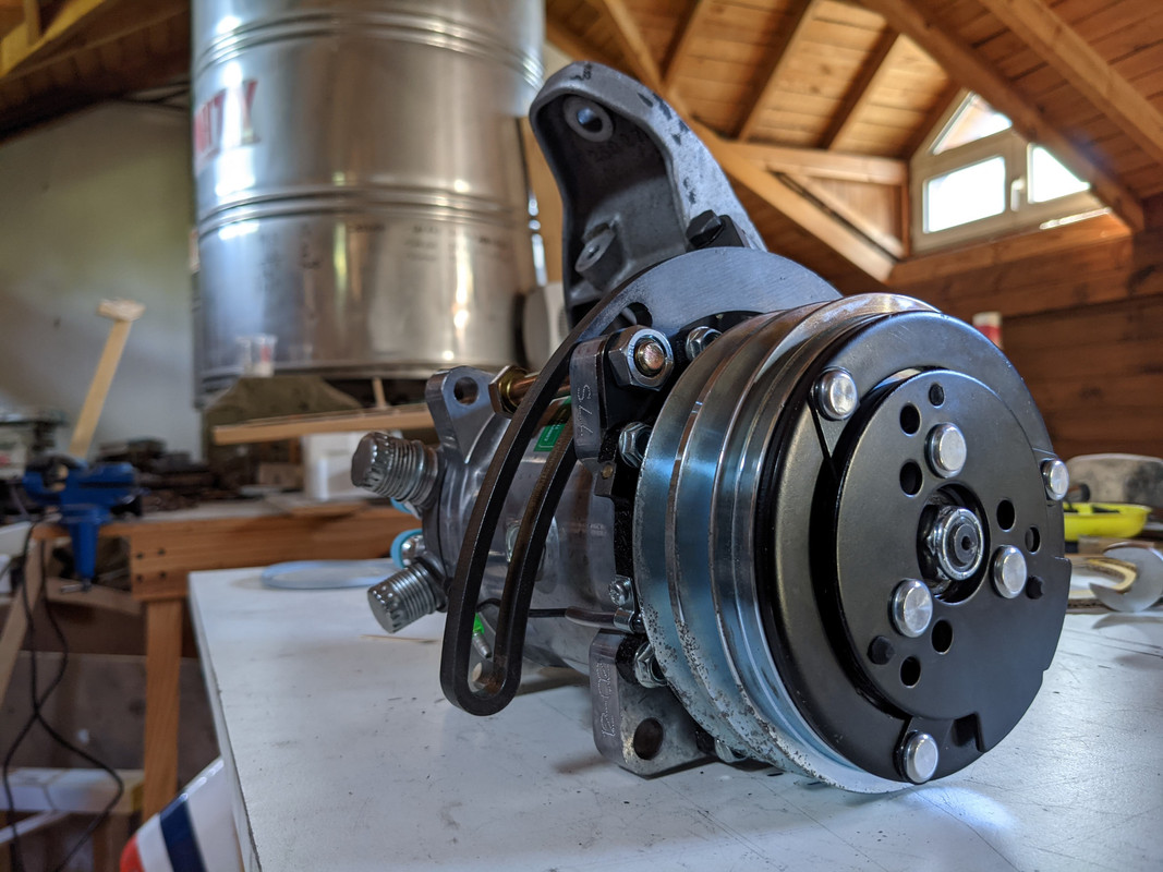

Front spacer/adjuster in place. I still need to source a 19mm spacer for the rear mount.
This connecting tab will get welded to the adjuster to tie it to the bracket

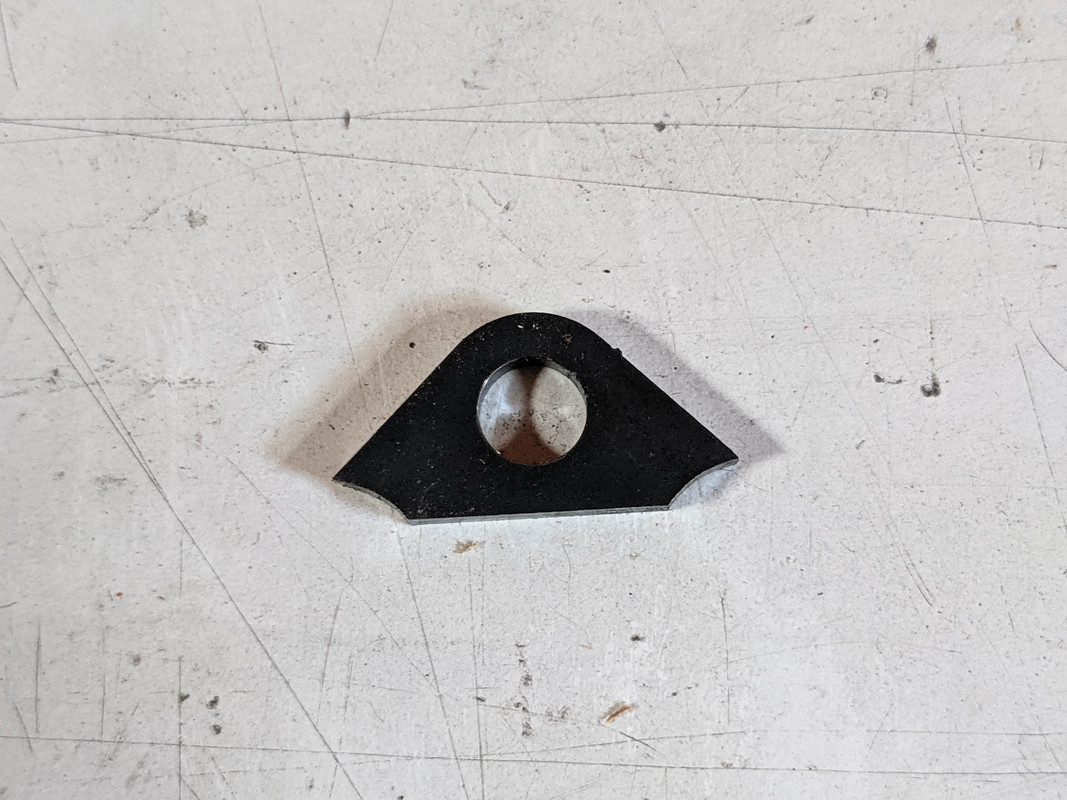

I designed this last piece for convenience. A locknut for the adjuster will get welded to it so it doesn't spin.
This should allow me to stretch the belt with one hand and lock the compressor in place with the other.
So all that's left to do now is to buy or have someone turn me a rear spacer, weld the tab and then mount everything on the car.
