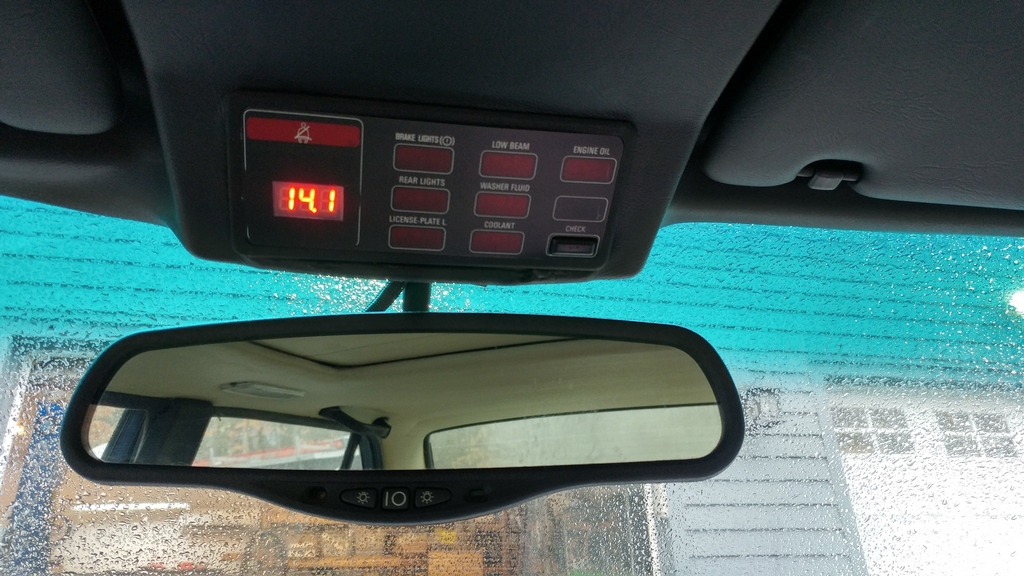

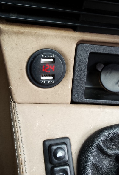

These cheap voltmeters are useful tools, if and when you remember to look at them
Re: Burned Out Battery (Alternator) Light Indictor...Major Drain
https://www.amazon.com/gp/product/B00YA ... UTF8&psc=1
My check panel came apart easily so installing the meter wasn't difficult.
indycar89 wrote: ↑22 Feb 2021 18:39
Nifty meter in the check panel - remember what/where you found it?
Where were you able to get the voltage signal from? Inside the Check Panel or ?
