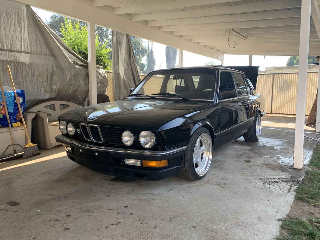

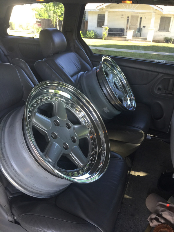

My first set of real 3 piece wheels :)

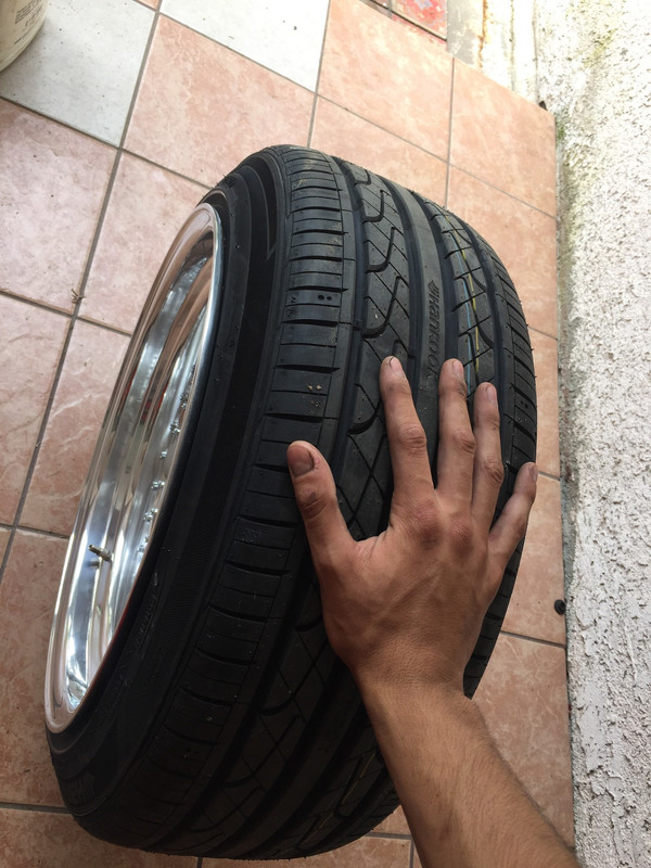

New tires
First time laying it out on her new wheels :)

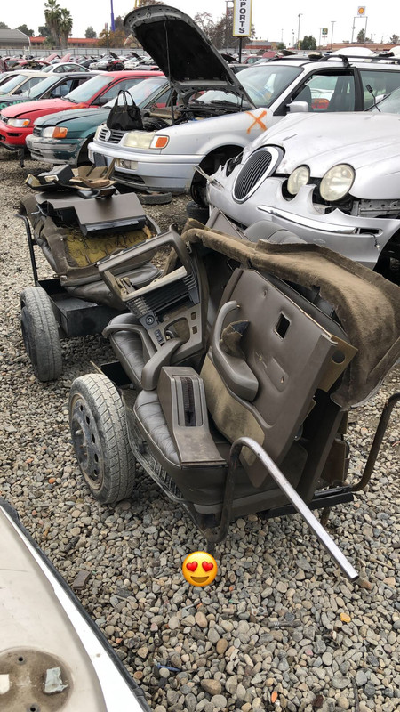

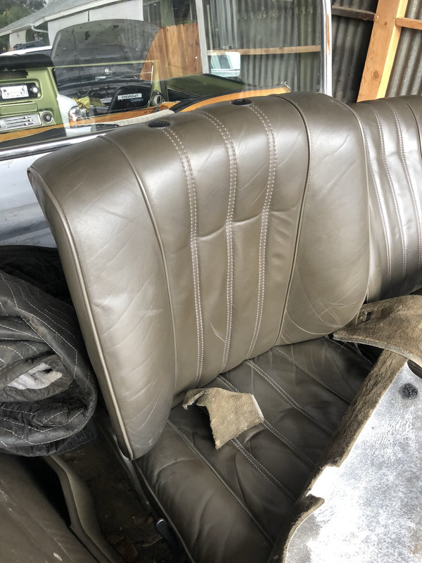

A month later i happen to find a e28 at a local junkyard to me with a full nutria brown interior. Everything was there & complete. The car had 85k miles & the interior is in mint condition as you can see. Also got the full interior for a whooping 300$ haha cant beat that.

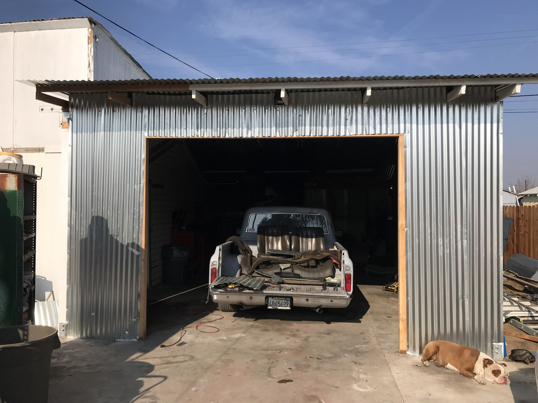

Hauled it back in the c10

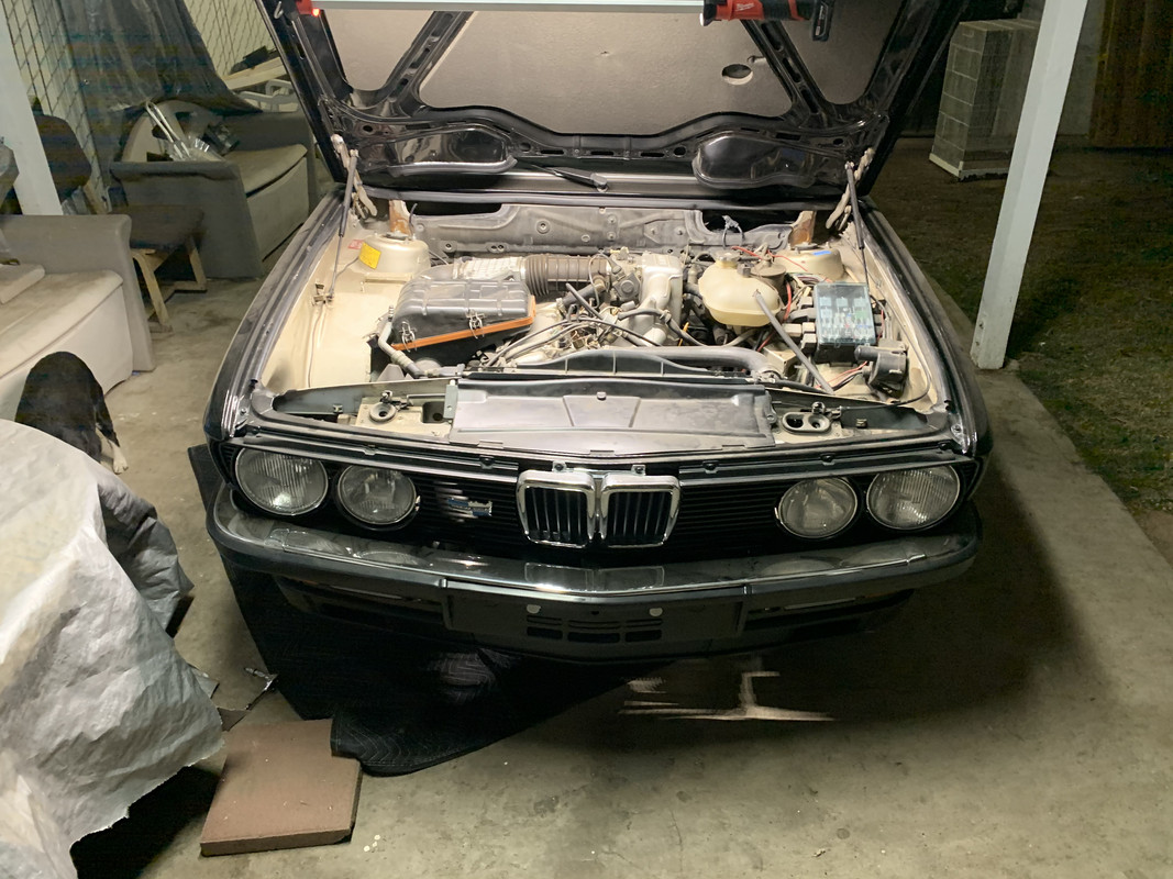

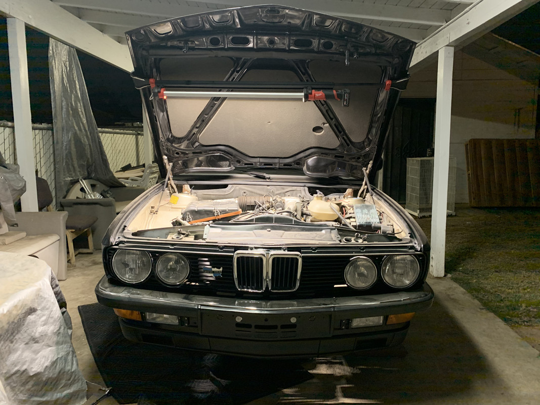

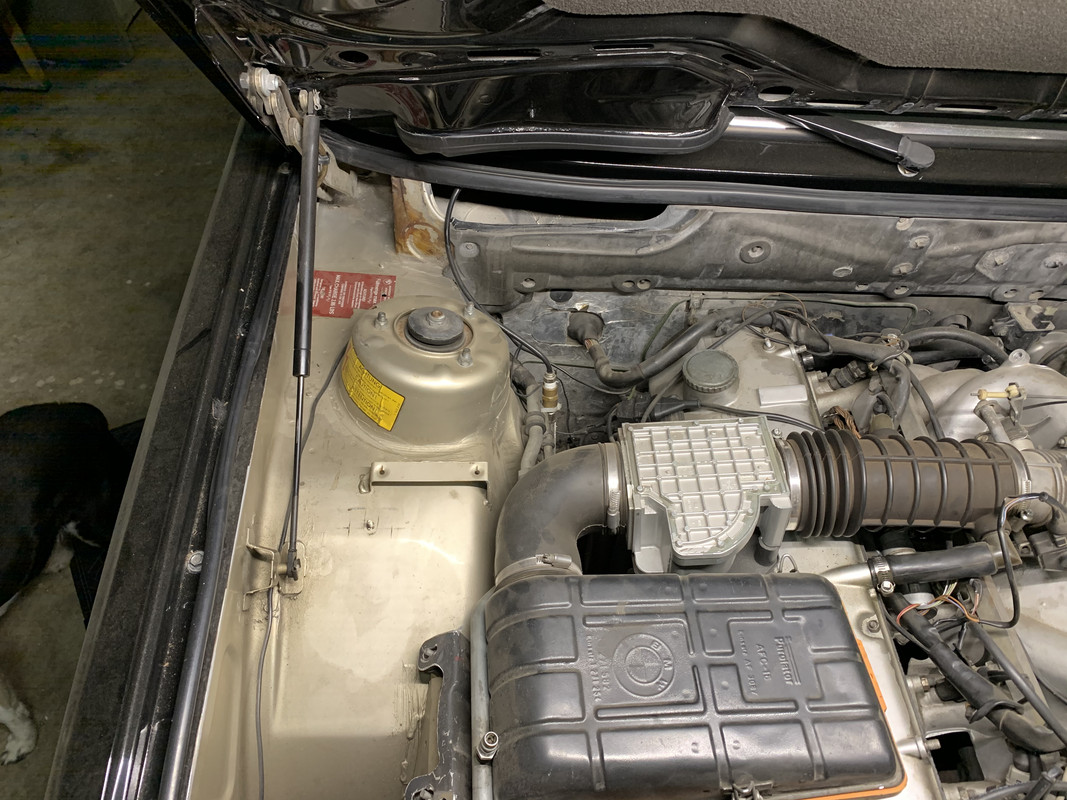

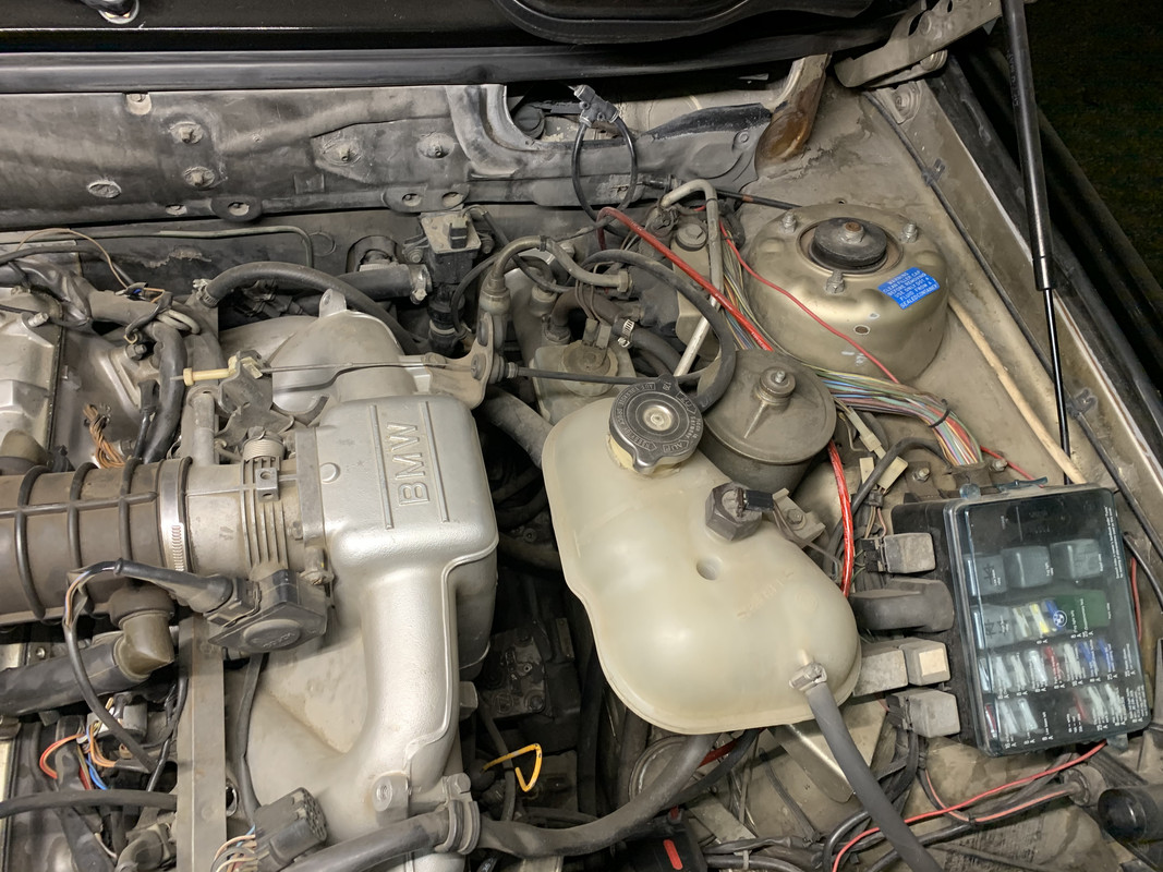

Ok so now the fun can begin this is the current status of the 533i. Last time it will have a m30 in it.

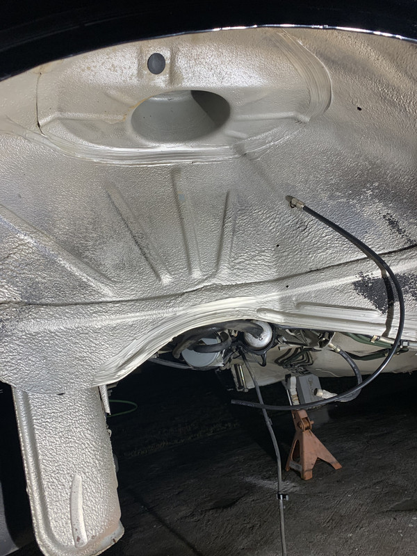

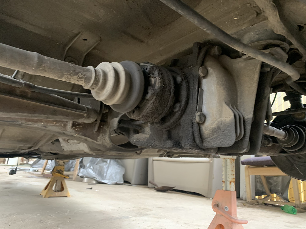

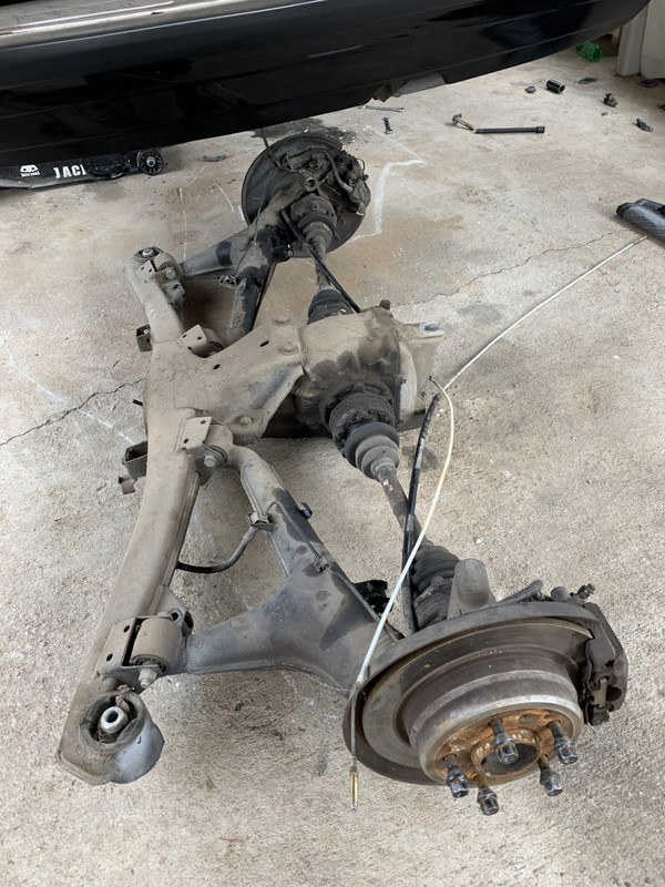

I started off with the rear end, i wanted to get the rear subframe out to get sent out for powdercoating meanwhile i can start tearing into removing the engine. 30 plus years of oil, dirt & grime on the rear suspension components.
And its out
That is the current state of the car as of today 12/6/19 i will keep you guys updated as i get along with the build. Please stay tuned & let me know what you guys think

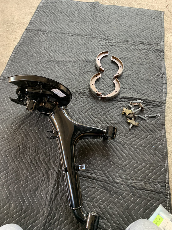

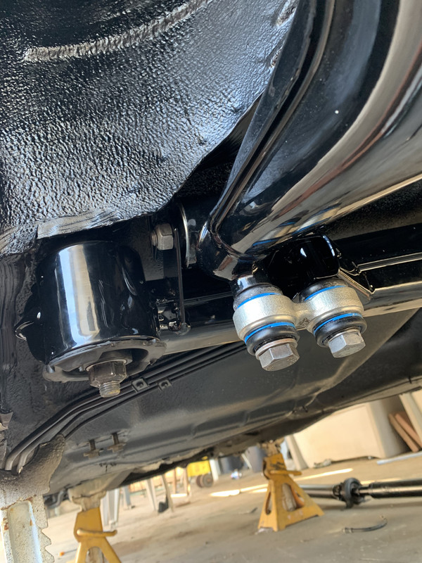

I got all my trailing arm bushings & rear wheel bearings pressed in at a machine shop forgot to take pics of that but you get the idea. I started to assmeble the parking brake parts with new shoes, hardware & basically everything new.

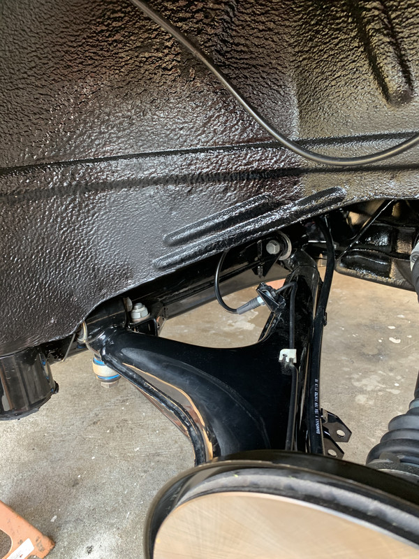

Then i decided to powerwash the wheel wells & give them a quick coat of paint.

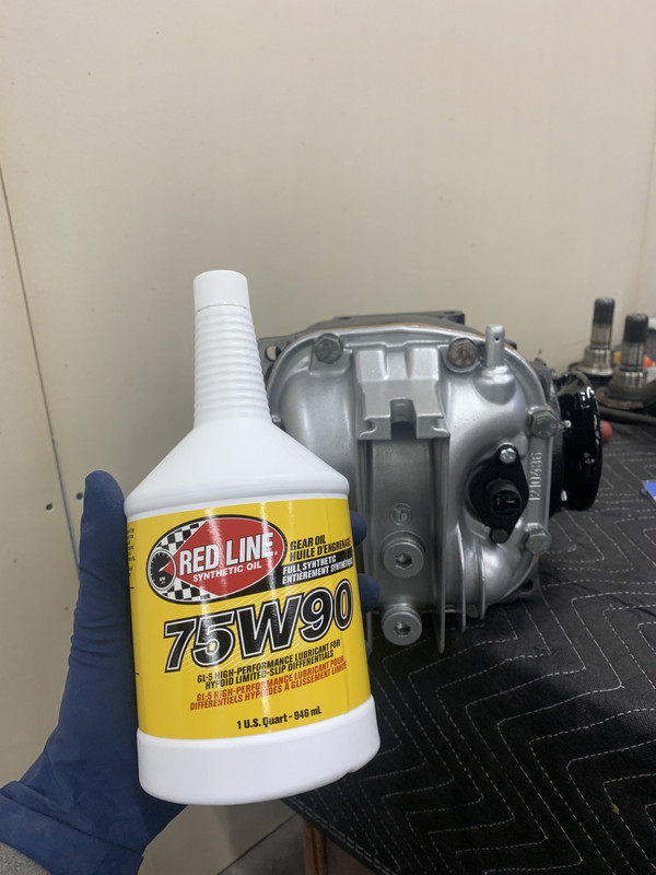

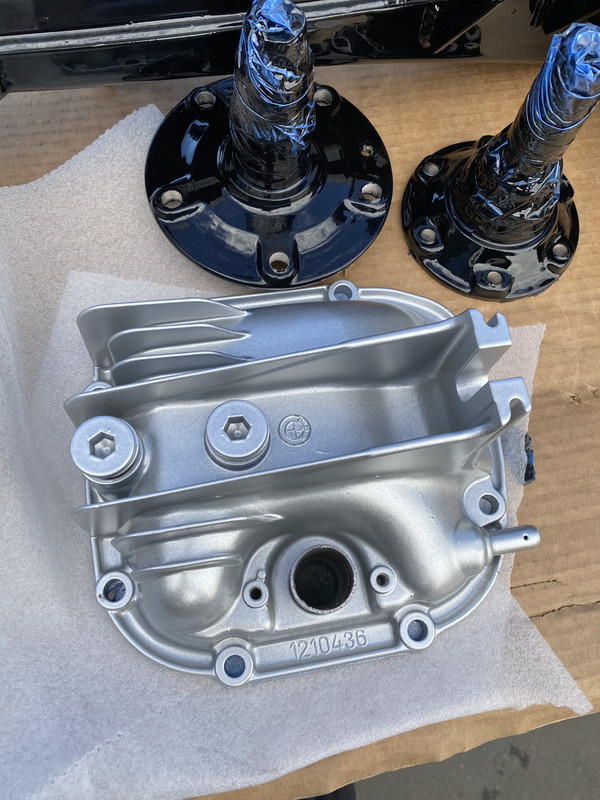

New diff got resealed & new fluid. Came from a auto e24 with low miles is what i was told from the guy i bought it from.

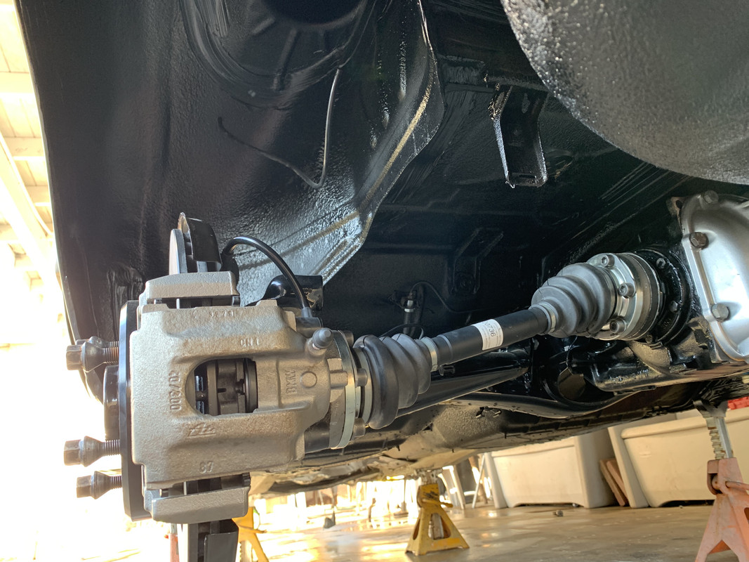

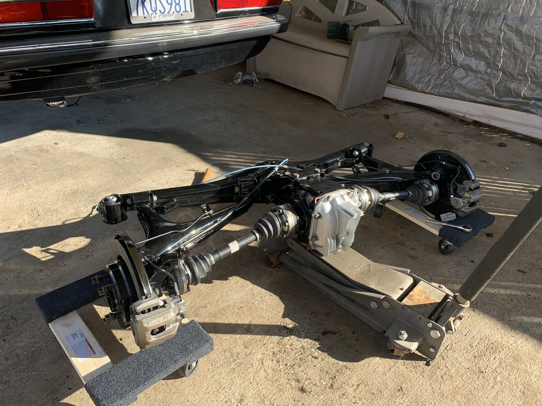

Finally go the subframe all together with all its new parts. Here is a quick rundown. I got new axels, stainless steel lines, 3.25lsd with 540i rear brake pads & new calipers. Paired that with some stoptech race pads. Also got new brake dust shields & new ebrake cables.

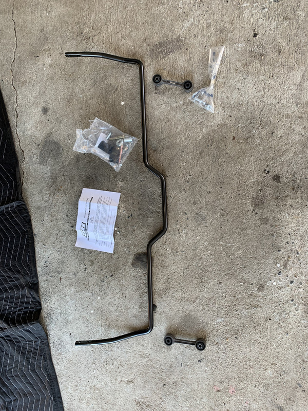

I choose to go with ST for sway bar upgrade.

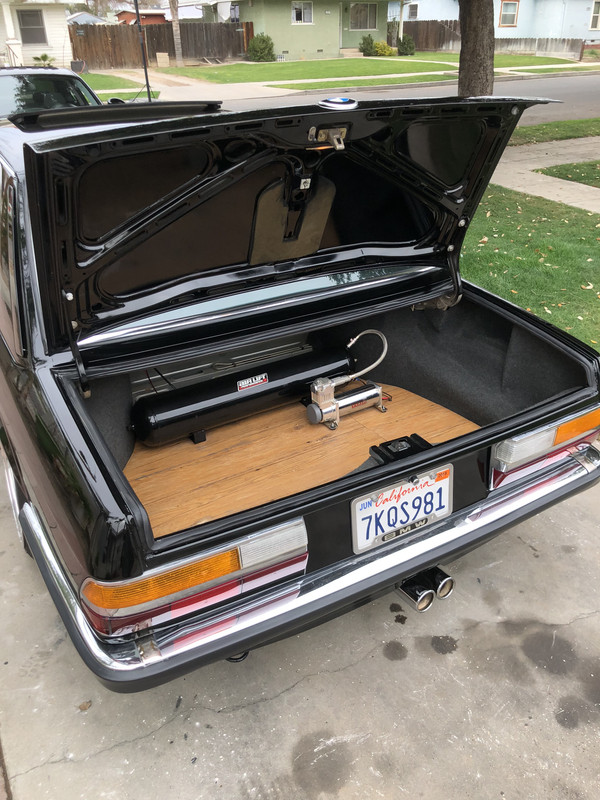

Did you really just try to justify the air ride due to bad roads. In Cali? :rofl:
