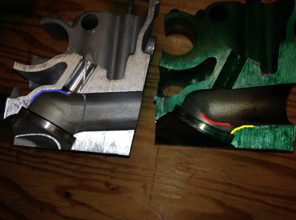

I am putting lots of toughts,I guess you could call that R&D,on porting the B34 heads I got.Some will be sacrificed for science.I have a couple B35 heads too,arguably these are better,most notably on the short side as can be seen on pic I posted comparing B34 and B35 ports.Since you are using forged pistons with a tiny bit higher compression ratio,you could use said better B35 heads.You would need oversized valves if you choose to have a good valve job done,which I reccomand.Might as well put quality exhaust valves while in there.
I have a world reknown head porter not far from where I live.I am about to pay him a visit to see what he can do for me and my modest budget.
I probably would have him test different things I'd do myself at home,on his flowbench.But dont hold your breath for it.
You have to decide if you keep stock intake manifold or not.Look at the drawing I posted earlier.
