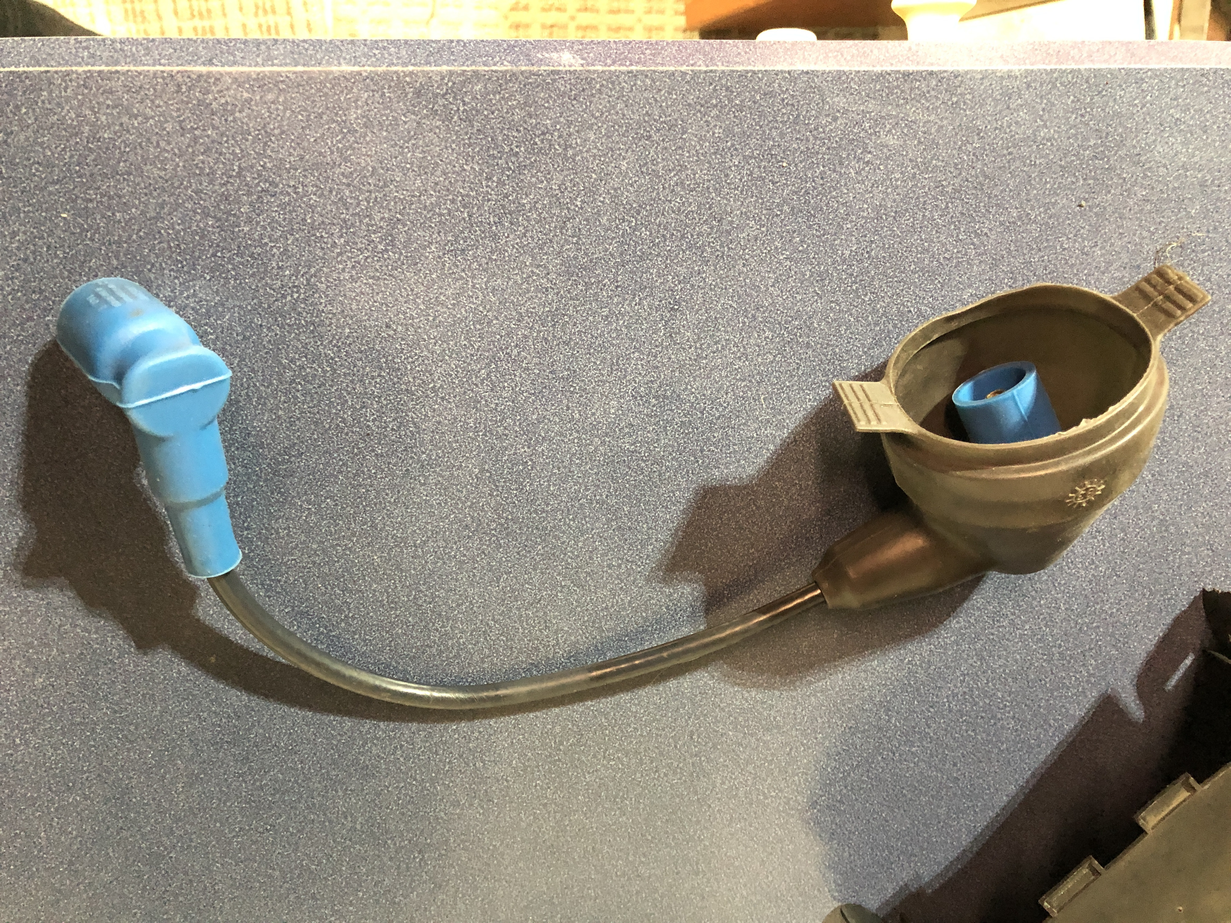

I have an 02/84 533i with bolt-on rotor.
This is the original wire I'm replacing:

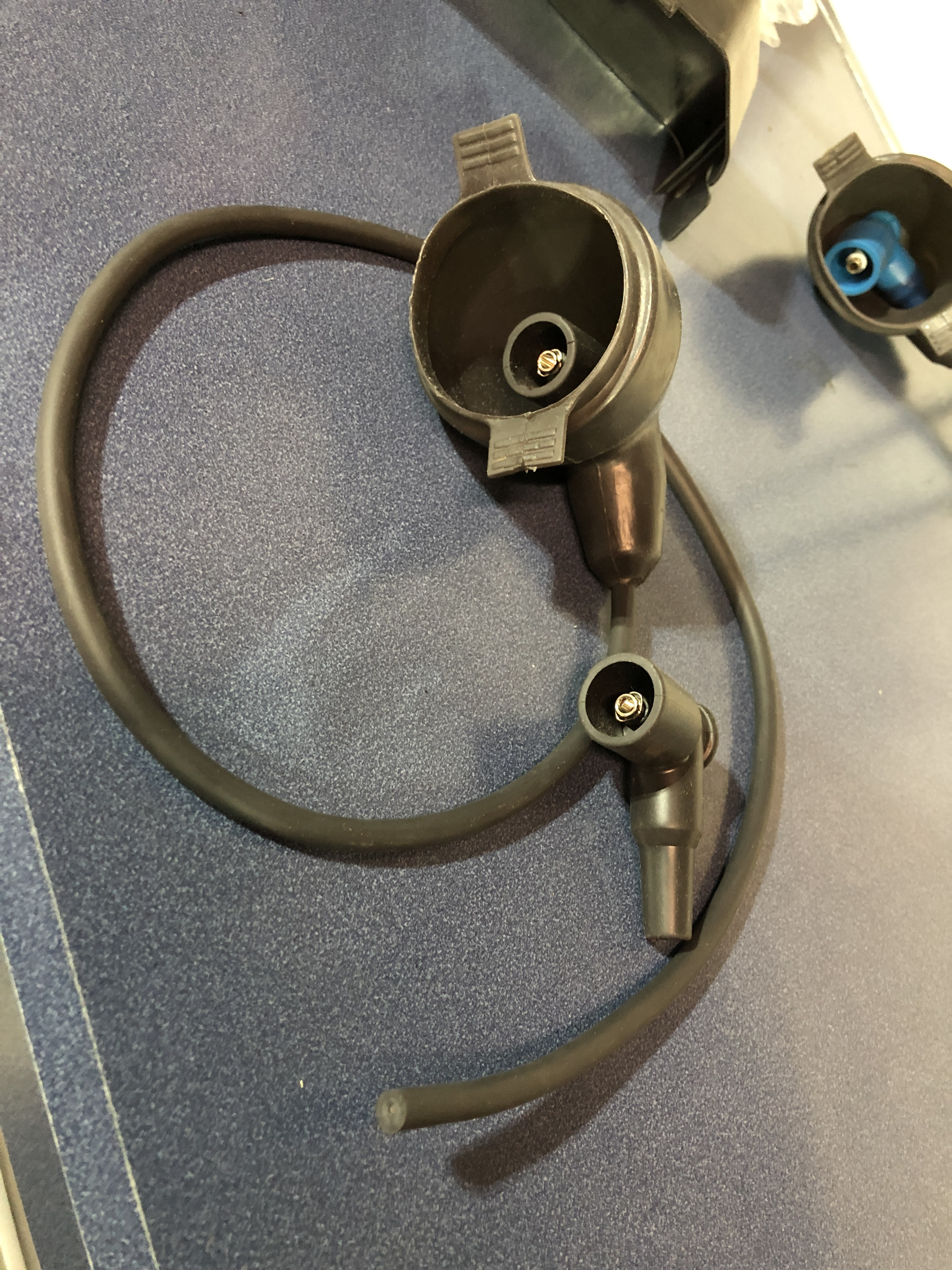

Here's the replacement wire. The brief instruction says to screw on, but very hard to tell looking inside if this is possible.

Its correct and how the coil wires come from Bremi. Cut to fit your car, it should have come with a small tube of grease, just apply a little of the grease on the wire end and feed it in and screw it onto the boot. It'll stop turning when its tight.

No, just cut to length and screw it on. Shine a flashlight in the boot, you'll see the prong that the wire screws into.

I step away for a couple of hours and Kojo has it all figured out for you. I first saw your pictures before seeing his posts and I was going to say, I see a screw in there, but he took care of it for you. :up:
