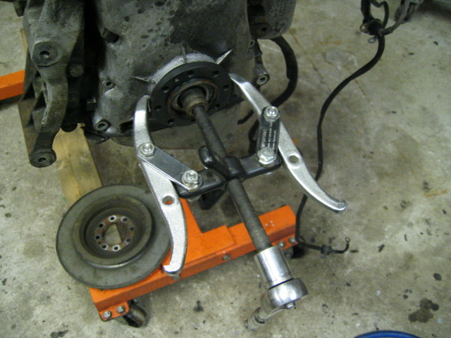

Found this image in another thread (viewtopic.php?f=3&t=126347).
Looks like the hunt is on for a hub puller.

I just used a plain old two-jaw puller I had in the toolbox, likely purchased from Harbor Freight for some other job years ago.

I agree, I have never had a problem getting the hub off the crank. But I was looking at the picture of the puller set up and was thinking if that won't pull it off pushing on the front cover is not going to go well.

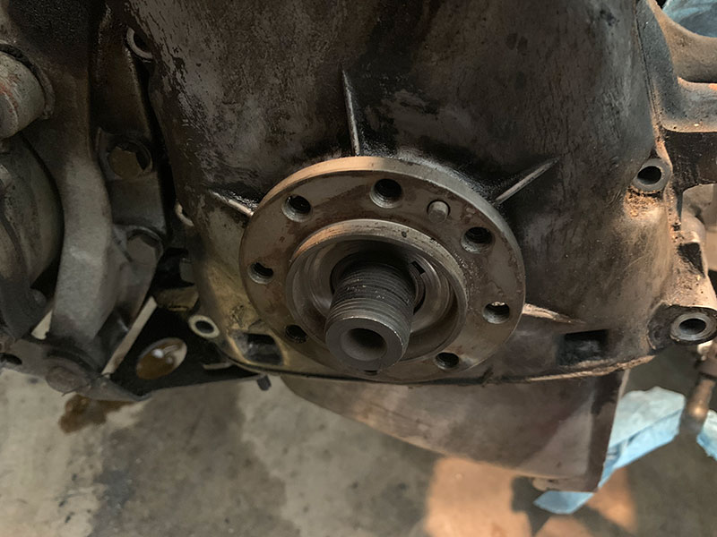

Alright, progress! The puller I borrowed wouldn’t fit between the condenser and the hub, so I removed the condenser and the A/C compressor (I’m going to go with Austin’s kit after some contemplation, so out they go). The hub is off, and I confirmed that all 13 bolts have been removed and the lower cover is clear to be removed ... but it won’t budge. I don’t want to force it — it seems stuck on the lower dowels and maybe the oil pan gasket. Maybe some heat will help?
Re: Jesus nut is free, but the hub is stuck!
Posted: Oct 18, 2020 6:34 PM
by code
Didn't end up using heat, just gently popped it free with a pry bar between the block and the little tabs on the timing cover. Piece of cake, and the oil pan gasket is intact. Score!
