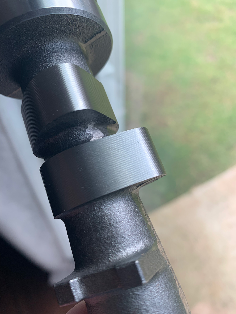

The replacement new billet 270 degree camshaft from IE arrived today. The first camshaft they sent looked like a regrind and had small raised bumps across the lobes, but to their credit they sent this replacement right away. This new billet cam has grooves across all of the lobes, deep enough that they catch your nail. Is this normal for a new cam, or should the lobes be polished smooth like the cam journals?

I haven’t bought a ton of cams, but when I have they’ve always been polished or at least smooth on the contact surfaces.
That kind of roughness seems like it could wipe out a set of cast aluminum lifters in a hurry. If you can catch a nail, that can’t be right. The cam bearing surface doesn’t look perfectly round either, but maybe that’s just the lighting.
For a quick expert opinion you might want to post this on a more active message board like the Grassroots Motorsports forum or similar.

Thanks, I’ll wait to hear what Ireland says first. I checked the lobes again, just to be thorough, and you can really feel the ridges just with your fingers. I think you’re right in that this would destroy those brand new rockers.

SlickDizzy wrote: Oct 18, 2020 10:58 PM I haven’t bought a ton of cams, but when I have they’ve always been polished or at least smooth on the contact surfaces.
The rockers are aluminum, but have a hardened wear pad, steel/cast iron I suspect, but much harder than Al. Still, I think you're right, looks like a file that would wipe them out.

IE got back to me this morning via email, after seeing the photo of the lobes they feel that I received a raw camshaft. Waiting to hear if they have a finished 270 new billet cam available.

I was almost ready to order a cam from IE, but I'm not so sure about it anymore. Quality control seems extremely sloppy and they should get it right at least the second time.
Why did you remove the first set of pictures? Truth should be out there.

Tiit wrote: Oct 21, 2020 4:58 PM I was almost ready to order a cam from IE, but I'm not so sure about it anymore. Quality control seems extremely sloppy and they should get it right at least the second time.
I agree that QC is sloppy, but the customer service has been nothing short of great. They sent out 12 new rockers (which were perfect) and said keep the others that were good as spares. The quality of the second cam was good, it just wasn't finished. Not making excuses, though, I agree the replacement should have been checked before being sent.
I am sending the two camshafts back, but can take pictures for posterity. I wouldn't hesitate to order from them ... hopefully I'll have the finished 270 cam here by the weekend and can post photos of that. Now, if the third cam is not up to par ...
