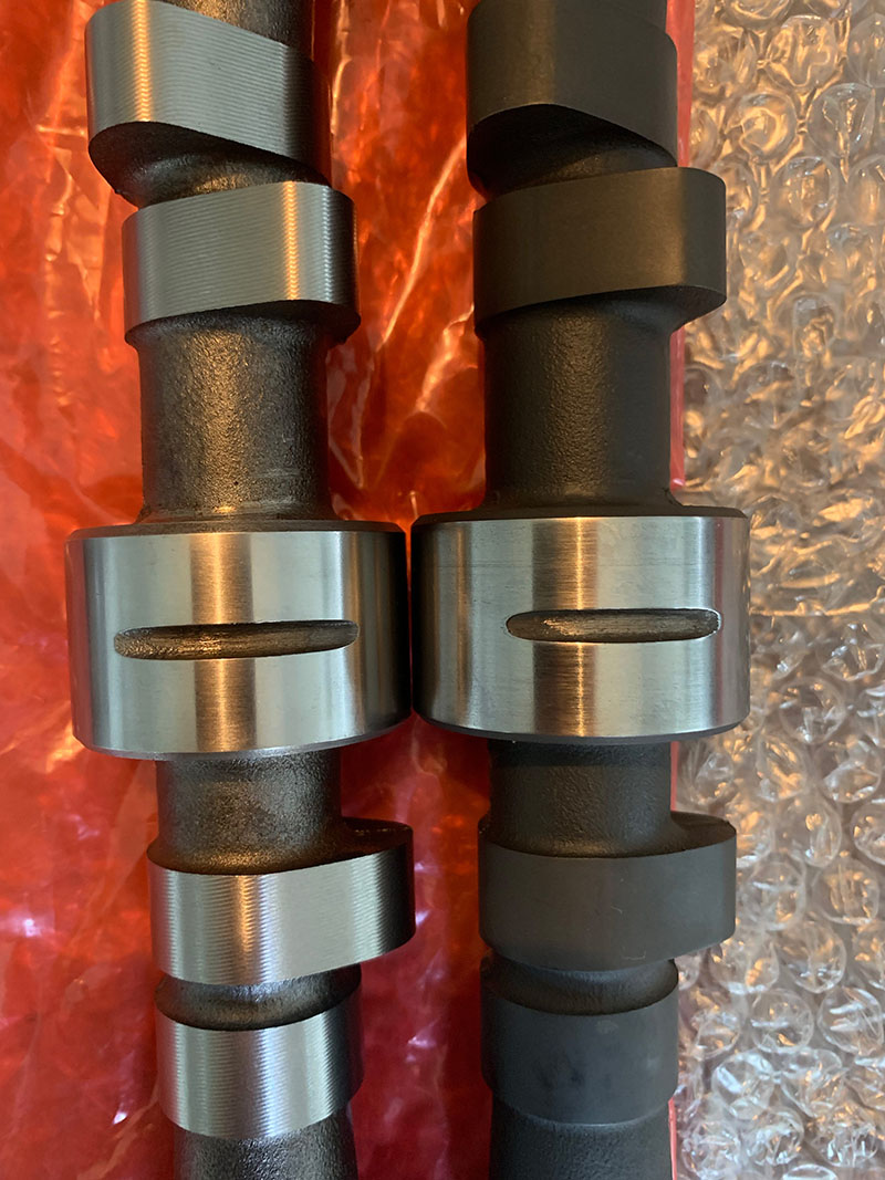

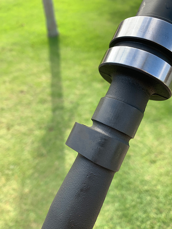

The replacement new billet 270 degree camshaft from IE arrived today. The first camshaft they sent looked like a regrind and had small raised bumps across the lobes, but to their credit they sent this replacement right away. This new billet cam has grooves across all of the lobes, deep enough that they catch your nail. Is this normal for a new cam, or should the lobes be polished smooth like the cam journals?

I haven’t bought a ton of cams, but when I have they’ve always been polished or at least smooth on the contact surfaces.
That kind of roughness seems like it could wipe out a set of cast aluminum lifters in a hurry. If you can catch a nail, that can’t be right. The cam bearing surface doesn’t look perfectly round either, but maybe that’s just the lighting.

Thanks, I’ll wait to hear what Ireland says first. I checked the lobes again, just to be thorough, and you can really feel the ridges just with your fingers. I think you’re right in that this would destroy those brand new rockers.

IE got back to me this morning via email, after seeing the photo of the lobes they feel that I received a raw camshaft. Waiting to hear if they have a finished 270 new billet cam available.

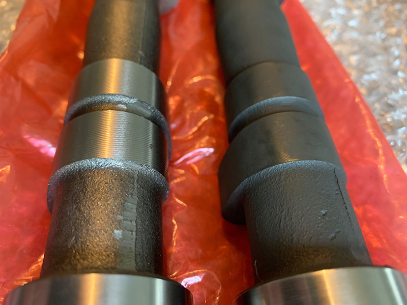

The third camshaft arrived this morning. Feels like I'm taking a step backwards here. While it doesn't have the raised bumps on the lobes that the first camshaft had, the lobes on this camshaft are the same (not polished). Attaching photos of the first cam, and a side-by-side with #2 and #3. Is the third cam (on the right in the side-by-side) what I should expect to receive for a new billet? Notice the slot in the cam journal is shorter, also (if that is of any significance).
Camshaft #1
Camshaft #2 (on left) and Camshaft #3 (on right)

I reached out to IE this morning, and Jeff Ireland provided some insight. He said, "We buy the unfinished cams so we can do various different grinds locally. Our cam grinder gives the cams a coating to aid break in and prevent rust." Makes sense, if these are coated the way they are that they wouldn't have a high polish. There HAS to be more members out there who have purchased IE camshafts. Right now, I'm leaning towards running it since the lobes are indeed smooth.
