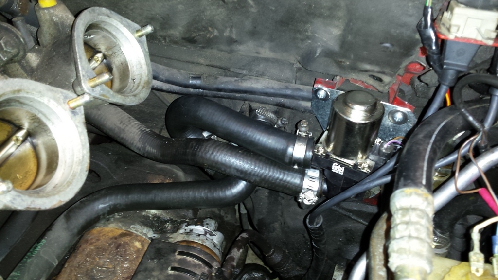

I had the airbox removed from the e46 last night and noticed the heater valve was right there on the left strut tower, so I thought I'd share some photos to show how it's mounted on that car. Mounting the e46 valve on an e28 and routing the hoses seems to have proven to be a bit of a challenge, and I had been thinking it may work to rig up to a mount to put the valve in a similar location and maybe even use the hoses from the e46. Wouldn't take much to make an improvement on the mounting location on the e28, especially for the eta with it tacked to the firewall down below the brake booster.
I highlighted the two hoses a bit to set them off from the rest of the under-hood grunge. Click the images to open the monster-size versions.

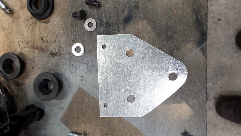

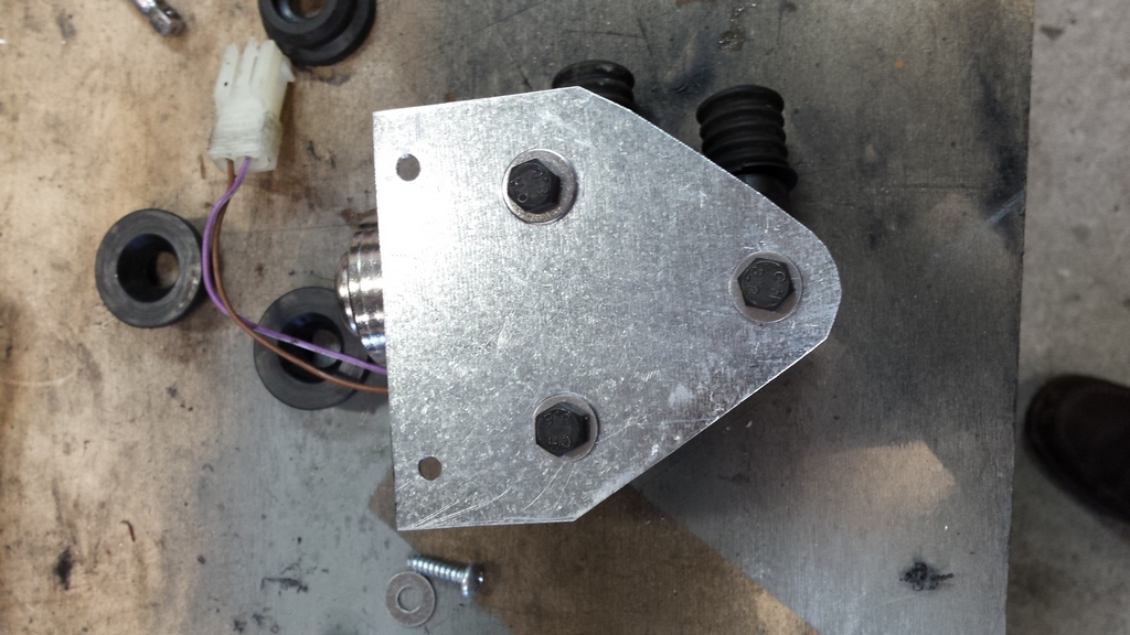

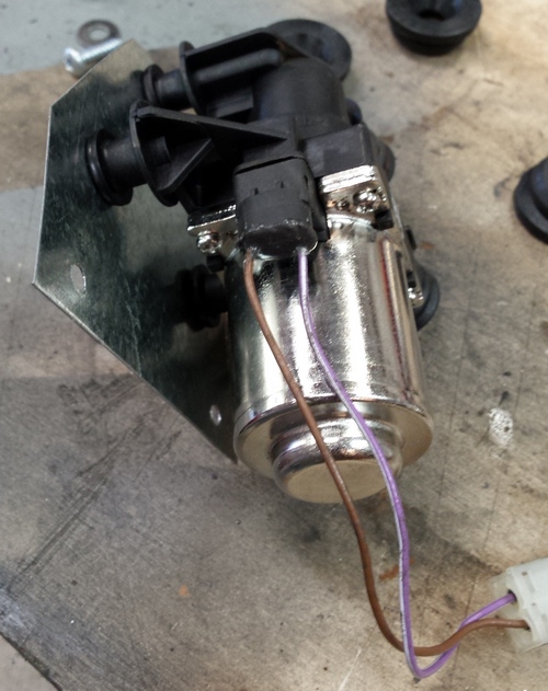

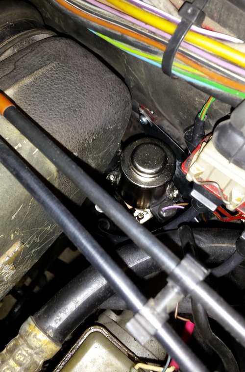

Here's an e46 valve installed on an M6 with a sheet metal bracket that you can make in like 30 minutes.
The bracket,
Removed the rubber grommets and tapped the holes with an m6 tap,
Attached the bracket with some short m6 bolts,
For the wiring I simply soldered an existing connector I had handy to the valve and epoxied it in place,
Hose layout. Sharkbite 1" barbed fitting was used to connect 2 pieces of hose together,
Just clears the intake manifold on the M6. It should be a lot more room on the M30,
