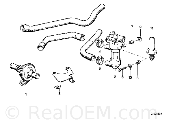

The mounting for M20 cars is different from M30 cars (the valves are different too).
M20
Attaches to a bracket attached to the brake booster. Sits below it and below the brake master cylinder.
The valve looks like this. Note the outlet on the bottom is at a 90 degree angle. This is the difference between the M20 part (64111373188) and the M30 part (64111373191) and is required because it sits so much lower that if the outlet weren't bent at 90 degrees the hose would interfere with the steering column.
On M20 cars I don't think there's a need to adapt the hoses as drastically as is needed for the M30. The inlet and outlet on valve are reversed, but the hoses in the car appear to be flexible enough to just fit.
You can see the half of the bracket where it attaches here:
M30
Attaches to a bracket attached to the firewall. Sits up high. Real OEM shows the same picture as for the M20, but this is incorrect. It shows the correct part number (64111373191 ) which looks like this:
The M20 valve should work on an M30 car, but the hoses may or may not line up; I don't know.
Vlad (my M30 car) has a brand new OE valve in it. So I'm focused on the M20..
A bracket that would support the E46 valve and attach to the original bracket that hangs off the brake booster would look like this:
The big rubber grommets on the E46 valve would just pop into the 3 holes in the bracket and the top two holes would be for mounting to the original bracket (using the rubber grommets that the original uses).
Made of 1/16" steel, powder coated black, will cost me about $200 for quantity of 10. If I got 9 people to commit to paying me $20 + postage I would make it happen. I doubt there's enough M20 interest for this to happen, so I'll probably just hack something together. But, chime in...
