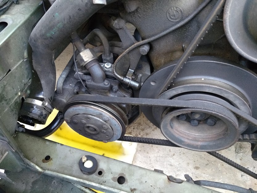

Here's a pic from one of my older posts. Like Mike said, that sensor is only used for diagnostics.
You would plug the engine to the BMW diagno test machine and use it to set the timing on the distributor. Dunno why it would be fitted to a motronic car.
