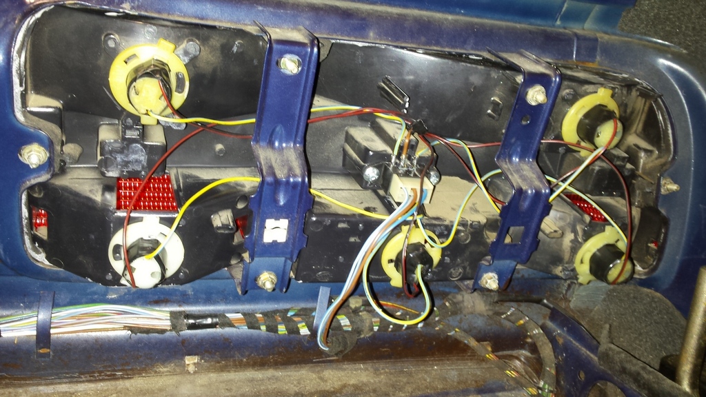

Why not go from the back? It's looks doable once you get rid of the metal power grid, which you don't really need if you run separate wires to each light. I did led bulbs on mine and got rid of the metal grid.

I'm not just trying to do LED bulbs, but LED strips. Also, the lens are cracked and leaking water bad. They literally get filled up.

I used to manufacture complete LED brake/tail/turn setups for E28s, but haven't for a long while. You're going to have to modify the housing and insert them from the back -- removing the lenses is not a good way to go about it. Then you can also get wider arrays in and place them further from the lens so it'll look better.
If your lenses are cracked and leaking, you need a whole new assembly.
